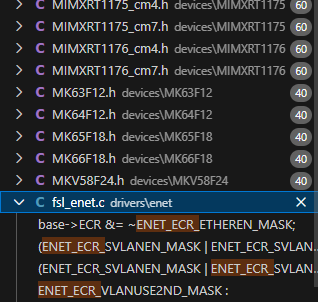

I see there is another implementation for ENET, under drivers/enet/. Has I understand, it's a mor generic implementation, but it also supports more Networking features (such as VLAN) for more advanced CPUS such as iMX series.
I wasn't able to compile with the enet/ driver, because I'm missing some definitions which are only available for iMX plateforms. Is there a chance I could use this driver for LPC546 ?

"I wasn't able to compile with the enet/ driver, because I'm missing some definitions which are only available for iMX plateforms. Is there a chance I could use this driver for LPC546 ?"
You cannot directly switch to drivers/nets/(i.MX series universal drivers)
This driver is designed for i.MX, not LPC, and cannot be used immediately.

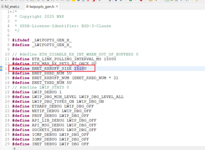

Base on your description.
The freeze is triggered only by VLAN‑tagged frames (~1522 bytes on the wire) coming from another VLAN. The current lpc_enet RX path assumes 1518‑byte frames;
when a 1522‑byte frame arrives, the RX length/offset computation underflows (e.g., buff1Len = -2) and corrupts the RX frame structure, which then trips the LWIP_ASSERT.
So i think you can try to change the ENET_RXBUFF_SIZE to 1522.
Harry
