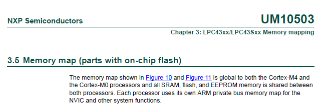

I am using LPC4367 controller in one of our upcoming project and product.  As per the user manual UM10503 it is mentioned that there is 16Kb of EEPROM. I want to use it for my application. But i want to access it through M0App core of LPC4367.
I check for the example codes but it is using M4 core.i want to used it through M0app. As per the data and the block diagram menioned below it is accessible to both the cores.

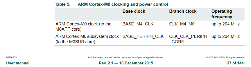

Also cosidering the following infor ther is a dobt that whether I can use it with M0App Core?
Here the base clock is M4 clk.

You are correct, the EEPROM is accesible through the M0 (application) core.  During the response time you may find the answer, but here you can check my reasoning.
  • Cheking further on the LPC4367 User Manual, the M0 core also has clock dependecy from the M4 base clock. The same case with other peripehals.

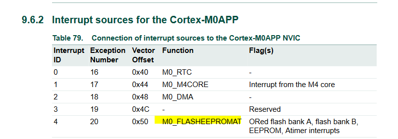

  • The M0 core also has an interrupt vector for the EEPROM.

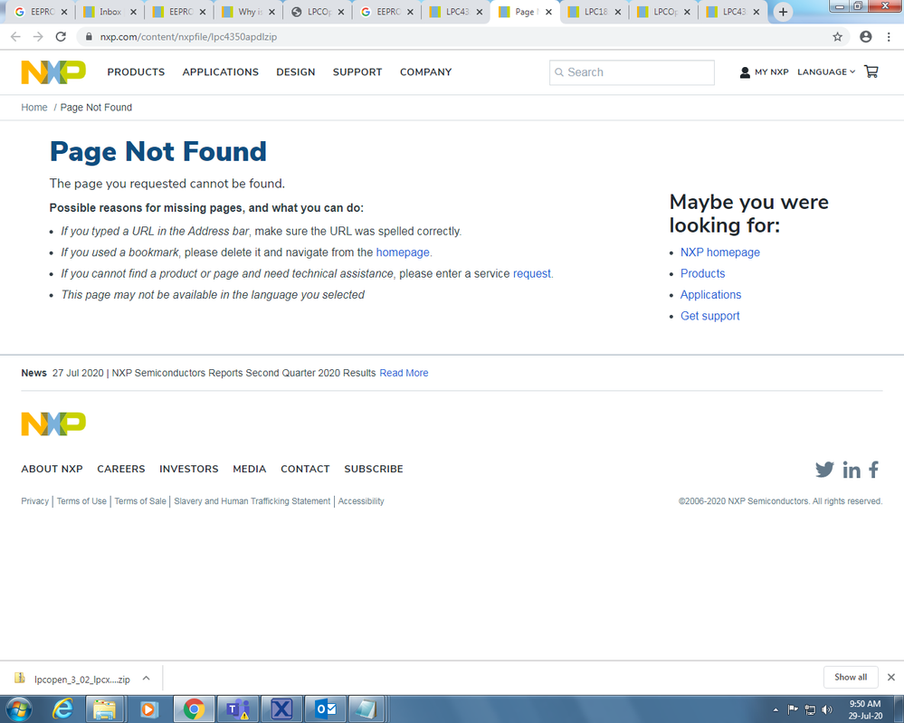

As per your input mentioned above i have initiated the code and modified the codes accordingly. Now am trying to access it in M0Core (M0App). I refere the code in forum and made the modification. But still i request you to share the information reagrding the EEPROM librarry or the functional code.
I tried from the below mentioned forum
LPC43xx and EEPROM
but when i click of the LPCware link ,I am not able to connect it, it shows below screen
Also I need the code for MCUXpresso since i am using Ver10.3.1_2233 for my development.
Request you to please provide the code for reference. Men while i am trying at my side for the EEPRO functionaly.
