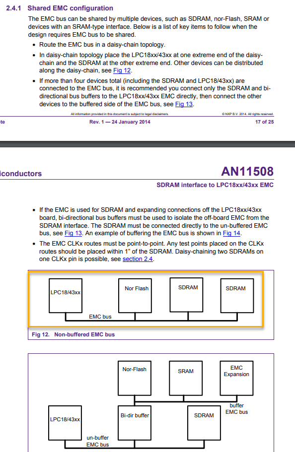

soledad
Please check the application note AN11508, you will find some recommendation for Shared EMC configuration (page 17):
https://www.nxp.com/docs/en/application-note/AN11508.pdf

priyankb
Hi Sol,
Thank you for the reply. I read this application note, but it is still not clear if I must use bus buffers if only static memories are used. Since in my project all the memories are static.
I also read this in application note AN10950:
When using a mixture of dynamic and static memories it is recommended that all signals being used in the static memory bus are buffered prior to arriving at memory devices.
So the question is even if i do not use dynamic memories, is bus buffers necessary for multiple static memory implementation?
