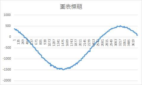

Dear Sir,
I been testing my LPC4370 board for a project,  encounter a problem that when changing descriptor match number, I did not see the expected effective sampling rate change.  below are three cases with match value equal to 80, 160, 1600.  they are very similiar.
I have been checking the code many times, couldn't figure out where went wrong.   Can anyone give advise, very appreciated !   raymundovelarde   I learn many from your posts, say thanks here.
           Match = 80                                                                    Match = 160
                Match = 1600
Test scenario :
* SET HSADC Clock to 20MHz
  * input signal is 60Hz sin wave
  * use interrupt to store 33,332 converted result to SDRAM,
  * using different match value to verify match value function
Code of HSADC setting is here,  full program attached as attachment

I don't see anything in the ADCHS setup that could be a problem.
The show data function hoever does not print consecutive addresses. You add addr_jump every loop which means you skip several addresses.
void show_data_out(void)
/* due to screen limit, we want to make output data stop when filling one screen full, so we take part of the sampl data */
  uint32_t *addr_a, i, addr_jump, Overrun_status;
  addr_jump = test_fifo_count / 3750;
  addr_a = (uint32_t *)SDRAM_A_PART;
  for(i=0;i<3750;i++)
    get_data = *(addr_a+=addr_jump);
    hi_da[i] = (get_data >> 16) & 0x0fff;
    if(hi_da[i] > 2048)hi_da[i] = (hi_da[i] - 4096);
    low_da[i] = (get_data >> 6) & 0x0fff;
    //Overrun_status = (get_data >> 1) & 0x00000001;
    if(low_da[i] > 2048)low_da[i] = (low_da[i] - 4096);
    printf("%5d ", low_da[i]);
Also you are reading LPC_ADCHS->LAST_SAMPLE[0] which never contains "packed" data (2 samples per word), and you did not set "packed data" any way.

I didn't pay attention to the enabled interrupts, but most of them only occur when there is an error.
I assume you are running the processor at the example default of 204MHz. You are running the ADCHS clock at 20MHz, with MATCH Number set at 80 you should be sampling at 250K sps, set at 160 you have 125K sps and at 1600 you have 12.5K sps so I doubt that   FIFO_OVERFLOW ever occurs.
DSCR_ERROR won't occur otherwise you would have no samples.
You have set FIFO_LEVEL to 1 so unless your processor can't keep up, the FIFO_FULL interrupt will not occur.
What I notice is that in your Interrupt Handler you don't check which interrupt occurred, also you don't clear the interrupt flag.
-Ray

cpchen
Ray,
We have solve the problem after adding clear interrupt on the interupt handler routine.  thanks for the advise.  we will now move on with faster HSADC sampling rate and using DMA to transfer to SDRAM. we will need to use 80MHz HSADC & DMA & SDRAM in our project .
It's good advise of placing to RAM,  we will not test it as the project will use DMA to store sample data to SDRAM,  thanks anyway.
