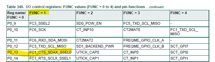

We are currently developing a new product, based around the LPC55xx series.
I noticed that some pins can be configured as SDAX or as SDA, or similarly, SCLX or SCL.
However, looking in the user manual of the processor, it is not clear to me what the differences between these functions are.
I also noticed that the MCUXpresso Config Tool doesn't even mention the X (just show SCL and SDA).
 For example:
  • P0_13:
    • FUNC = 1: FC1_CTS_SDAX_SSEL0
    • FUNC = 5: FC1_RXD_SDA_MOSI
  • P0_14:
    • FUNC = 1: FC1_RTS_SCLX_SSEL1
    • FUNC = 6: FC1_TXD_SCL_MISO
Can someone explain to me what the difference is and why I should choose one over the other?

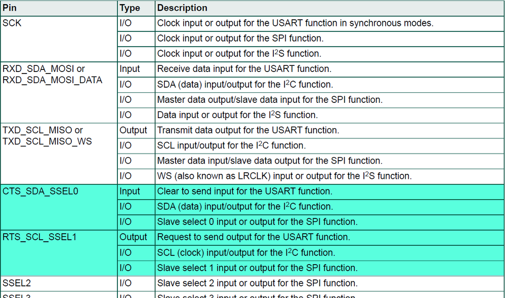

The two names serve to identify either the SCL and SDA signals of the I2C bus, however, the "X"s on the names appear to be a mistake, according to tables 595 and 591 of the LPC55xx User Manual:

So there are two ways to configure these pins to the exact same configuration? I would not have expected that.

@Sebastian_Del_Rio , so you are saying that to configure SDA for, e.g., P0_13, one can either select FUNC = 1
or select FUNC = 5:
Please confirm that both configurations are equivalent.
I ran into this issue recently and I have to say that this redundancy is clearly unexpected and left me puzzled.
