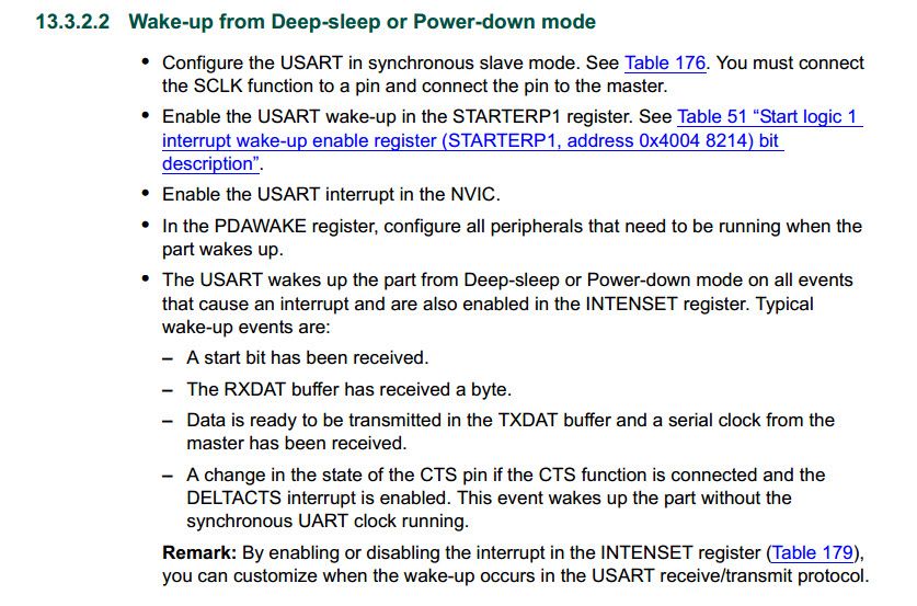

To synchronize with the slave target, you needn't to reset MCU as the MCU will reboot.
I'd like to suggest that you can configure the USART be able to wake up the system form sleep mode in asynchronous or synchronous mode on any enabled USART interrupt.

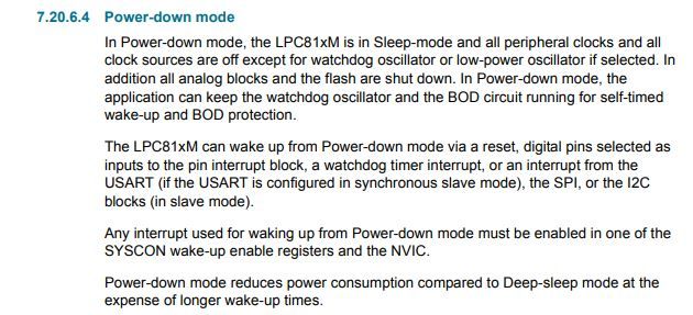

Start bit has been received in asynchronous mode this will wake up from sleep mode?
4,443 Views

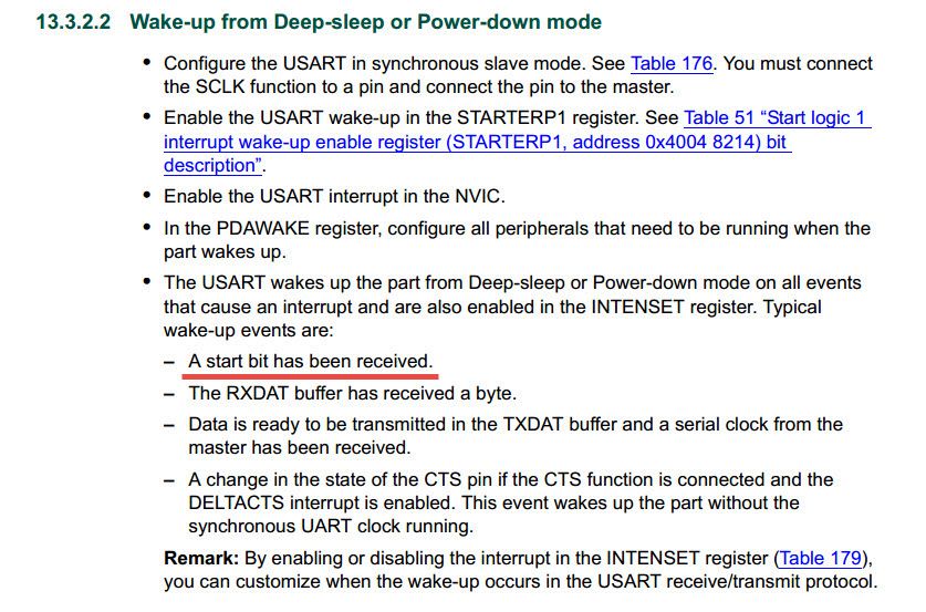

jeremyzhou
Hi Ranjith Shanbhag,
Thanks for your reply.
1) Start bit has been received in asynchronous mode this will wake up from sleep mode?
     Yes, as the Fig 1 demonstrates.

jamesl1
No.
The last post explains how to use the USART to wake up the part from deep sleep when using SYNCHRONOUS comms reception. In deep sleep, the USART has no clock so it cannot receive a start bit in ASYNCHRONOUS reception, which is what the OP is asking. The quotation from the manual spells it out very clearly by saying "you must connect the SCLK function..."
I am struggling with the same issue, and I'm now trying to get PININT on PIO0_0 to bring me out of deep sleep. I may then choose power-down mode instead because I can still allegedly wake up from power-down using PININT.
