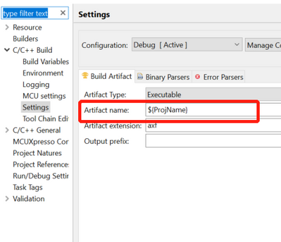

Hello!
I've just started with the MCUXpresso.
I've been trying to debug the program from the last two days but there's an error that's keep occuring. I tried so many solutions on Internet but nothing is workign.
I'm posting the whole console with an error:

arm-none-eabi-size "DALI_Slave_LPC111x.axf" ; arm-none-eabi-objcopy -O binary "DALI_Slave_LPC111x.axf" ".hexDALI_Slave_LPC111x.bin" ; checksum -p LPC1114_302 -d ".hexDALI_Slave_LPC111x.bin"
arm-none-eabi-size: 'DALI_Slave_LPC111x.axf': No such file
arm-none-eabi-objcopy: 'DALI_Slave_LPC111x.axf': No such file
Error: Cannot open checksum file .hexDALI_Slave_LPC111x.binmake[1]: [makefile:47: post-build] Error 1 (ignored)

converse
Senior Contributor V
It is trying to create something called ".hexDALI_Slave_LPC111x.axf". I'm guessing that you tried to change the output to generate a ".hex" file and screwed something up...
As this looks like an example project, I suggest you delete the project and re-import the example.
5,498 Views
Chish
It's a customized project that have already been programmed. Even, I've corrected the file name from ".hexDALI_Slave_LPC111x.axf" to "DALI_Slave_LPC111x.axf". It still doesn't show any memroy or global variable.
On the memory tab, it's blank. On the global variables it's also not showing anything.

ZhangJennie
HI
This project doesn't generate DALI_Slave_LPC111x.axf but  " .hexDALI_Slave_LPC111x.axf" . check if you correctly set the output file name
If still can't resolve, Is the project a NXP demo code? if yes, please send the link thus we can test it directly.
If your own project, please send this project here thus we can check it directly.
