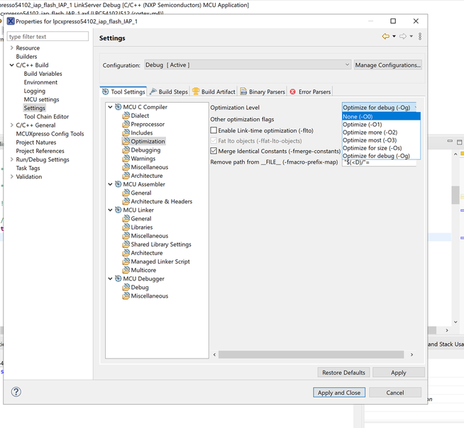

I'm running into an issue as soon as I launch debug session.
I'm running a SDK IAP driver example for  LPC54102J512 microcontroller (OM13077 board) without any changes. The code successfully builds but when I launch debug session it gives following error:
Can anyone please tell why I'm getting this?
I tried a few things and even setup whole thing on a separate PC but same issue.
Also I found that when I remove all the printf statements this error goes away. (UART0 is routed to printf for debugging).

The scenario is when I run debugging on any code containing PRINTF  it gives me this message  "No source available for "StrFormatScanf() at 0x____ ".
I have even tried the SDK examples and its driver examples as it is but it keep giving this message.
I found one thing that when I change the compiler optimization level from none (-O0) (set by default) to Optimize for debug (-Og) this message goes away. why is that so?
