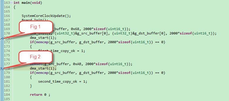

I have a question about re-enabling a DMA memory to memory copy on LPC4370.
I have successfully set up the DMA controller to do a one time memory to memory copy using the scatter/gather method (user manual 21.8.5). If I would like to do the copy from the same source address to the destination address again, do I need to program all the same registers again?
If re-programming the registers is not needed, how is the re-enabling DMA transfer achieved?
Please help! Thank you.

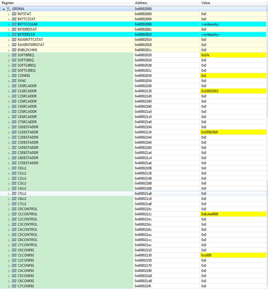

Hi mtenw,
Thanks for your reply.
I'd like to exemplify the register change between the two break points, then you can figure out the root cause of the issue.
                                                                      Fig 1
                                                               Fig 2
Hope it helps.

I figured out the problem, the channel configuration register must be re-initialized.

I do have a function to set up the scatter/gather mode, and another function to start the DMA transfer. My question is if the destination and source address is the same, saving the time of setting up DMA is beneficial. Can I just call "setup" once, then call "start" for the subsequent transfers?
Your answer suggests calling "setup" and "start" every time is necessary. Is there any way to save the "setup" time for the subsequent transfers?
Thank you.

Recalling the function is the safest way, however I think your idea is feasibly.
I was wondering if you can share the demo code and let me to do some investigations.

Please refer to the .c file. The first DMA transfer is successful. But without calling the "init" function again, the second one DMA transfer failed.
Also, can you share the demo code in main() to check if DMA transfer is completed? Can we assume the transfer is completed right after dma_start() in the .c file?
