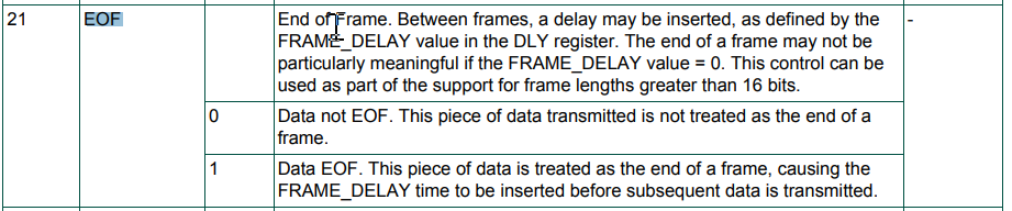

The reference manual mention the following regarding larger frames:
Larger sizes can be handled by splitting data up into groups of 16 bits or less. For example, 24 bits can be supported as two groups of 16 bits and 8 bits or two groups of 12 bits, among others. Frames of any size, including greater than 32 bits, can be supported in the same way.
Sending two groups of 12 bits with SSEL de-asserted between 24-bit increments, for instance, would require changing the value of the EOF bit on alternate 12-bit frames.
If you only want a single interruption between transfers you could try using the DMA interrupt instead of the SPI one.

Hello davenadler‌,
The EOF bit is used to manage the transmissions greater than 16 bits, so you will need to set this bit and set the FRAME_DELAY to 0, this way you could receive the full ADC frame as two transfers, or if you want as 3 8-bit transfers.
Also, if you need the SSEL is not asserted between transfers this bit could help you to do it.
In the SDK (link for download here), there's an example called spi_dma_b2b_transfer that you can use as reference.
