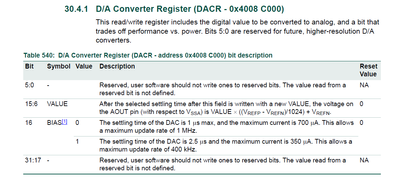

These micros family have a 10 bit DAC which means data buffer is 10 bit wide and can't take any value greater than 0x400.
looking at the code, file multi_tone_gen.c --> GenerateMultiTone (struct wave *t) ;
DAC->DACR = ((output >> 10) & 0xFFC0) + 0x8000;  // make unsigned and output to DAC
When I run the code the input to  DAC buffer is always greater than 0x400.
what am I missing here, am I just supposed to scale it down?

even after that line of complex shifting the final input to the DAC buffer is still larger than 0x400
when I divide that value by 0x64 then the sound gets much smoother. However, still there is slight roughness in it
DAC->DACR = (  (((output >> 10) & 0xFFC0) + 0x8000) / 0x64  );

As the following void GenerateMultiTone (struct wave *t), there is complex shifting operation, I suppose that the long output  variable has  25 valid bits, that is why there is 10 bits right shift operation so that it matches with the DAC format:
Pls debug the code step by step so that you can see the valid bits of the variables.
Hope it can help you
XiangJun Rong
