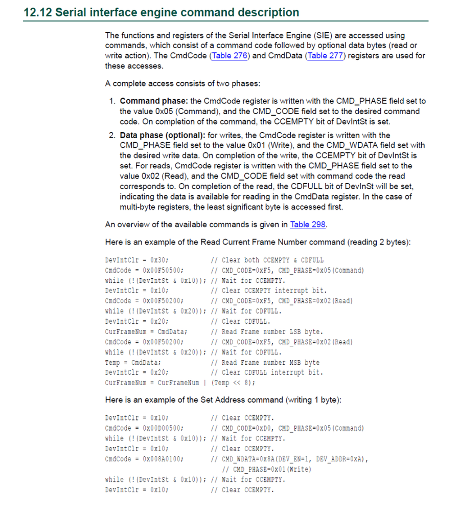

Thanks Carsten,
This is a perfect example to implement custom USB device. I got the device enumerated.
But the problem is that I was not able to receive interrupt on data reception. The register you initialized after connect function is not present in LPC4088 which is a base board of my project. Is that a reason I am not able to receive interrupt? Please help...
Priyank.
6,804 Views
carstengroen
Senior Contributor II
Priyank,
I might be on VERY deep water, but I THINK that you need to issue a SIE command to enable that on 4088 (I do this on LPC2458 to get the same effect).
On that, I set bit 5 in this command:
Don't take my word on it, but I think this is the way you should do on the 4088 also !!
