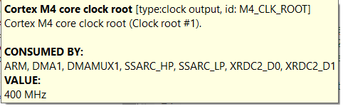

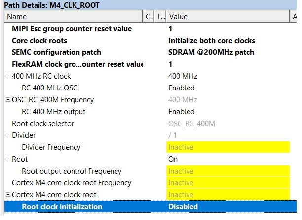

Could you please more details of this? Only when you add the root clock of CM4 the issue no longer happens?
This is strange since even when enabling M4 root, the M7 does not executes this part of the code as it is not compiled on M7 core.
#if __CORTEX_M == 4
    rootCfg.mux = kCLOCK_M4_ClockRoot_MuxOscRc48MDiv2;
    rootCfg.div = 1;
    CLOCK_SetRootClock(kCLOCK_Root_M4, &rootCfg);
#endif
I think that the cause of this is the enablement of a PLL steps before core clock. Could you please detail the exact clock that enabled solves the issue?
Omar

Thanks Omar,
I have inserted the code generated form MCUXpresso with ConfigTool->Clocks (that we use in our application)

you can see that M4 is OFF, so if we change the code in this way
//    CLOCK_PowerOffRootClock(kCLOCK_Root_M4);         old code
    /* Configure M4 using OSC_RC_400M */                               enable clock CM4
     rootCfg.mux = kCLOCK_M4_ClockRoot_MuxOscRc400M;
     rootCfg.div = 1;
the M4 clock ON solves the issue.

Although the RT1171 does not have a second core it still has the M4 Root clock which is used for source for other modules such as JTAG. So the suggestion is not to power-off the Root M4 but do not initialize it.
Omar

I'd like to understand that the M4 root must be ON because these pheripericals are used by M7 ?
3,330件の閲覧回数
Omar_Anguiano
Correct, it is suggested to leave the root enabled as there are other modules that feed from that root such the ones on the image as well as JTAG.
Omar
