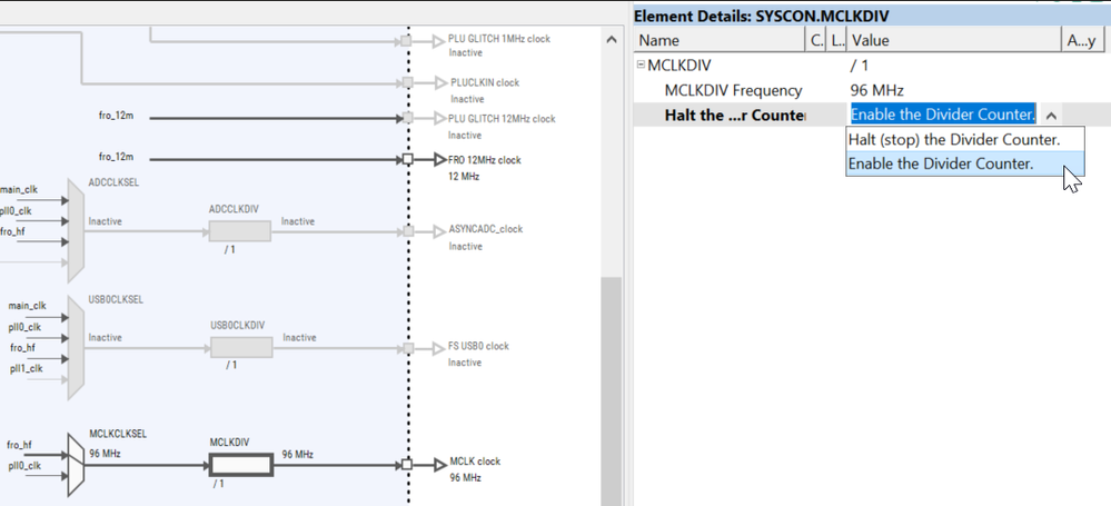

Hello everyone.
Can anyone tell me how I can activate the MCLK clock select clock. It appears as inactive. I don't have an external oscillator.
Thank you very much.
Best regards.
2,703 Views
FelipeGarcia
Hi Nadia,
Please make sure you are enabling the divider counter.
Felipe
- We are following threads for 7 weeks after the last post, later replies are ignored. Please open a new thread and refer to the closed one, if you have a related question at a later point in time.
2,712 Views
Nadia
