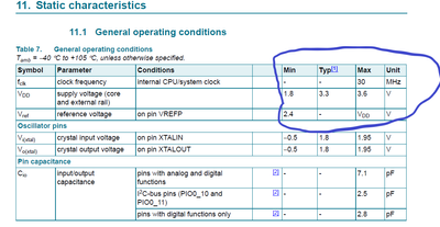

As the following Table 11 in data sheet of LPC82x, the maximum core/system clock frequency is 30MHZ
at most in the full temperature range from -40C to 105C.
At the room 28 C temperature, the LPC82x may work fine in 60Mhz even 72MHz, but we do not guarantee it works fine above 30MHz in the full temperature range from -40 to 105C.
For the chip speed, the flash reading speed determines the chip working speed range mainly, moreover, the chip has large working margin, that is why you can run above 30MHz.
In conclusion, we do not suggest and guarantee the LPC822 can work above 30MHz at the full temperature range reliably.
