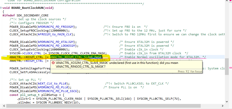

I'm using the SDK 2.6.3 on an LPC55S69 and while setting up the clocks, the code generator uses an undefined identifier.
It's the ANACTRL_XO32M_CTRL_SLAVE_MASK identifier and it isn't defined in the CMSIS Peripheral Access Layer for LPC55S69_cm33_core0
After some searching I found it a reference in the "clock_config_c.js" file but again, that's the only reference and on compilation it throws out errors.
I found this to be the case in both the stand-alone tool as in the IDE.
What shoudl this value be? Can I change it manually?
Thanks!

Hello Tom,
Yes, I can reproduce the issue on my side.
The value of "ANACTRL_XO32M_CTRL_SLAVE_MASK" should be 0x10.
