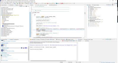

Hi NXP
i just debugged with a SDK example Basic discovery loop
i can building a project but when i debug to the board that make a problem
Break at address "0xdeadbeee" with no debug information available, or outside of program code.
Failed to execute MI command:
-data-disassemble -s 3735928558 -e 3735928698 -- 3
Error message from debugger back end:
Cannot access memory at address 0xdeadbeee
like that... do you have any idea about that problem?

I think you would need to debug into the SDK code, down to instruction level if necessary.
I do not have a CLRC663 board. But even SDK examples might contain bugs occasionally.

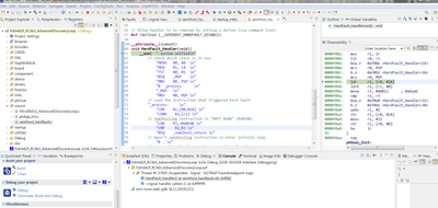

Thank you for your replying .
i changed a debug information and it made other breaking point
i used a SDK example i think project doesn't have problem...
Thread #1 57005 (Suspended : Signal : SIGTRAP:Trace/breakpoint trap)
HardFault_Handler() at semihost_hardfault.c:61 0xf092
<signal handler called>() at 0xfffffff9
Now at least you got somewhere.
You can check the SCB fault registers to decode the reason, and/or single step through the preceeding assembler instructions to see where and why it faults.
The value looks suspiciously like a preset value for a stack check. Which would point to a stack overflow at runtime.
If this happens in the debugger before it stops on a breakpoint, try to disable "run to main", and start debugging at the reset vector.
