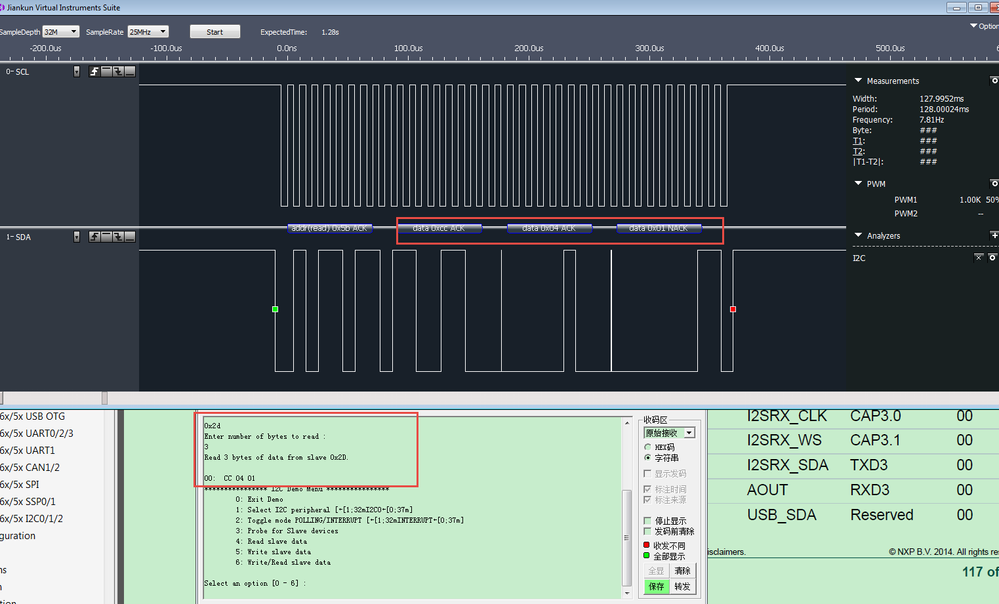

kerryzhou
Hi Mallikarjuna Reddy,
    Please try to use the LPCopen I2C code on your side.
    I have test it, and use the Chip_I2C_MasterRead function, it works ok.
  This is the lpcopen test wave:
You can find it can receive more than one byte.
Kerry

kerryzhou
     Whether the master can read the correct data or not, it is not only determined by the master, it is also related to the slave.
     Please check the I2C communication wave between your master and the slave, then post your wave when you can't receive more than one byte.
     Please also refer to the lpcopen code, to check your configuration is correct, you can refer to the LPC1769 I2C code from this link:
