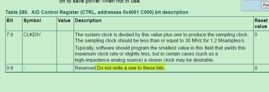

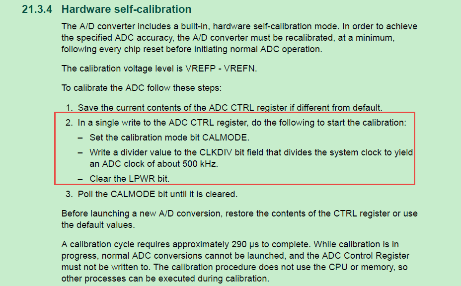

I am working with a LPC824. Why is firstly the /*Set calibration mode*/?, shouldn't it be last after the 500KHz SetClockRate?.
And other cuestion, what does it mean by ADC_CR_CALMODEBIT?  it says in UM10800.pdf at page 327 "21.6.1 ADC Control Register"  that the bit 8 (the corresponding of ADC_CR_CALMODEBIT) is reserved.
Thanks so much and regards. Daniel.

   Answer your two questions:
1. Why is firstly the /*Set calibration mode*/?, shouldn't it be last after the 500KHz SetClockRate?.
This is the calibration correct cycle, the chip just design it like this, you can't change the operation sequence.
You can find it from chapter:
2. what does it mean by ADC_CR_CALMODEBIT?
CALMODE it bit 30, you can find it from the user manual:
I think maybe you want to ask ADC_CR_ASYNMODE, it is bit 8, I think it just want to clear these bit.

Kerry Zhou  thanks so much. You are aright, I wanted to ask about ADC_CR_ASYNMODE...
