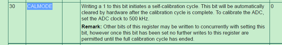

In adc_8xx.c there is a function to calibrate the ADC: Chip_ADC_StartCalibration:
/* Start ADC calibration */
void Chip_ADC_StartCalibration(LPC_ADC_T *pADC)
    /* Set calibration mode */
    pADC->CTRL |= ADC_CR_CALMODEBIT;
    /* Clear ASYNC bit */
    pADC->CTRL &= ~ADC_CR_ASYNMODE;
    /* Setup ADC for about 500KHz (per UM) */
    Chip_ADC_SetClockRate(pADC, 500000);
    /* Clearn low power bit */
    pADC->CTRL &= ~ADC_CR_LPWRMODEBIT;
    /* Calibration is only complete when ADC_CR_CALMODEBIT bit has cleared */
I am working with a LPC824. Why is firstly the /*Set calibration mode*/?, shouldn't it be last after the 500KHz SetClockRate?.
And other cuestion, what does it mean by ADC_CR_CALMODEBIT?  it says in UM10800.pdf at page 327 "21.6.1 ADC Control Register"  that the bit 8 (the corresponding of ADC_CR_CALMODEBIT) is reserved.
Thanks so much and regards. Daniel.

Hi Daniel,
   Answer your two questions:
1. Why is firstly the /*Set calibration mode*/?, shouldn't it be last after the 500KHz SetClockRate?.
This is the calibration correct cycle, the chip just design it like this, you can't change the operation sequence.
You can find it from chapter:
2. what does it mean by ADC_CR_CALMODEBIT?
CALMODE it bit 30, you can find it from the user manual:
I think maybe you want to ask ADC_CR_ASYNMODE, it is bit 8, I think it just want to clear these bit.
Wish it helps you!
Kerry

vaque
Kerry Zhou  thanks so much. You are aright, I wanted to ask about ADC_CR_ASYNMODE...
Thanks a lot! Regards. Daniel.
