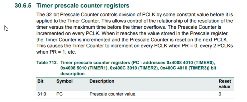

You can use the Timer prescale counter registers
Sol
