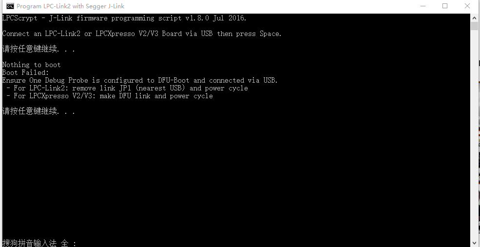

neomissing
I have also encountered this problem, LPC onboard simulator can not DFUQQ截图20170420192438.png

jeremyzhou
Hi neomissing,
Please refer to the reference manual to set the correct configuration to assure the MCU boot form the USB.
