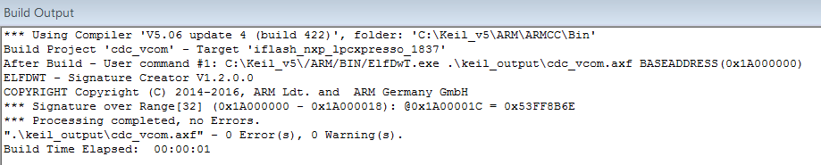

Carlos_Mendoza
Hi Yuanbin,
I have tested on my side and the examples are working correctly:
I noticed from your build output that the errors reference the dfu_composite project, please make sure the project cdc_vcom is set as active before compiling. Also, did you added a folder named RTE to the dfu_composite project?
Best Regards!
Carlos Mendoza
Technical Support Engineer

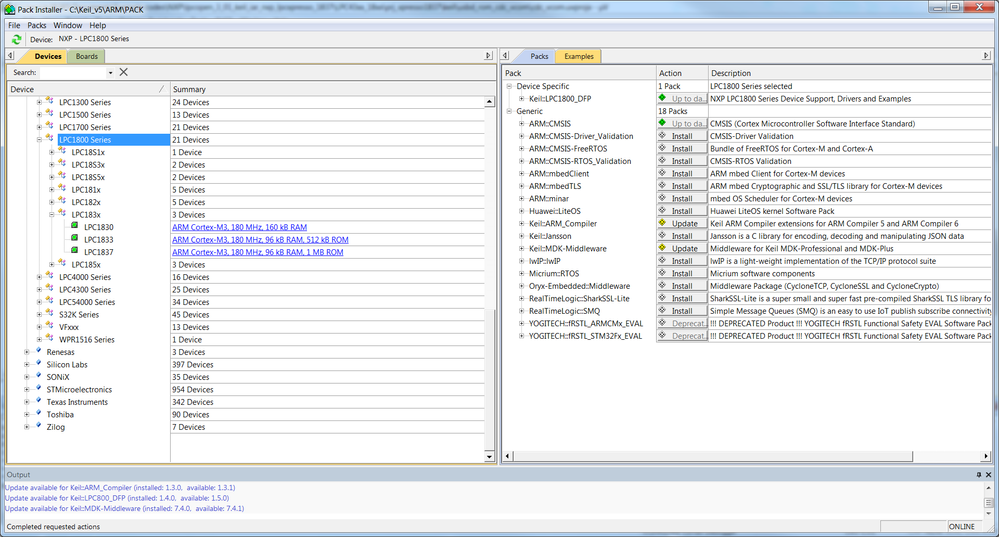

Carlos_Mendoza
Hi Yuanbin,
Please make sure you have the correct Packs installed, here is the information from my side:
Do you have the LPC1800_DFP  and CMSIS packs installed?
Best Regards!
