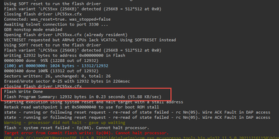

MCUXpresso has also been unable to program the processor. However, I have managed to mass erase it using the GUI Flash Tool. The errors when trying to program from MCUXpresso are attached.
I've compared the schematic and PCB design to AN13033 (Hardware Design Guidelines for LPC55(S)xx Microcontrollers) and the two seem to match.

From your screenshot, image successfully programed into flash:
What about "programming header" meaning, LPC5526 not same with lpc1313. Again recommend you crate a new project based on lpc5526, try to debug.
