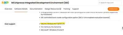

I'm new to NXP and am considering the LPC11U6 for a design. However, I'm Linux-only: I don't have a Windows computer or workstation, and haven't used Microsoft since last century.
Can I use NXP development tools under Linux? Most grateful for any assistance.
903 Views
Celeste_Liu
Hello @Gvinity ,
Thanks for considering our products.
---> Yes. I recommend that you use MCUXpresso. It is compatible with Linux.
MCUXpresso IDE for NXP MCUs | Linux, Windows and MacOS | NXP Semiconductors | NXP Semiconductors
The SDK for LPC11U6 is in LPCOpen and it can be used in MCUXpresso. For the specific method, please refer to the link below.
MCUXpresso IDE - Using LPCOpen Examples | NXP Semiconductors
Hope it can help you.
