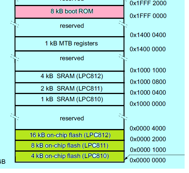

I use LPC812.
I erased All flash memory.
Can I rewrite ROM API ?
1,455 Views
diego_charles
Hello Shojiro,
Since the ROM APIs  reside  on an area different than Flash memory, it should  not be  possible to erase them after erasing the flash memory.
From figure 2.2.1 Memory mapping,  LPC81x UM.
Other point to have into account is that the APIs residing on boot ROM will not require the flash memory to execute commands  and routines, instead,  they use pointers to certain areas of the boot ROM space.

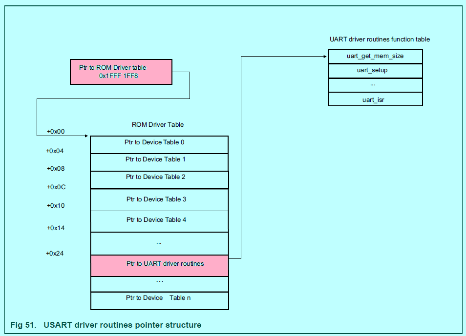

  • The other APIs ( like Power Profile, I2C-bus ROM API, and USART API )  requiere a pointer to the ROM driver table (located on boot ROM ) to  call their respective routines. pastedImage_6.png
From Fig 51. USART driver routines pointer structure.LPC81x UM.
I hope this information helps you.
