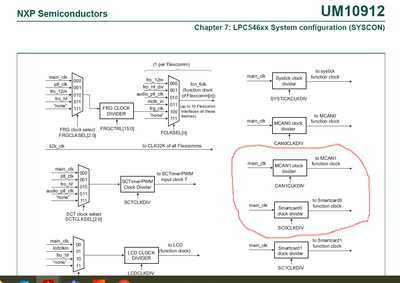

Regarding the baud rate of CAN, it is dependent on the CAN driving clock frequency and CAN bit timing, pls refer the section 35.8.4 Nominal bit timing and prescaler register for CAN bit timing.
For the CAN module clock, pls refer to the screenshot:
The CAN driving clock is main_clk by a divider.
If you set the baudrate as 500KHz, the bit cycle of CAN should be 2uS.
Hope it can help you

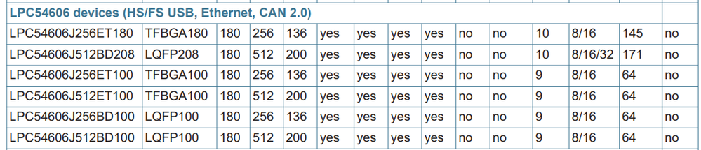

Based on CAN protocol, for the standard CAN, one CAN packet can only include 8 bytes at most, for the CAN-FD protocol, one CAN packet can include 64 bytes at most. I suppose that you use standard CAN, you have to transmit/receive 8 bytes in a packet at most.
The LPC54606 only supports standard CAN rather than CAN-FD.
If it is not what you expected, pls tell us if you use standard CAN or CAN-FD.

We're using LPC54606J256 microcontroller, this doesn't support CANFD and supports CAN2.0 as per the data sheet. So we're configuring it as standard CAN mode.
