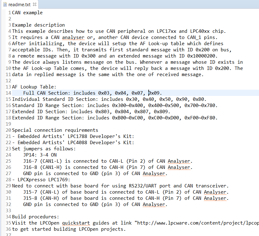

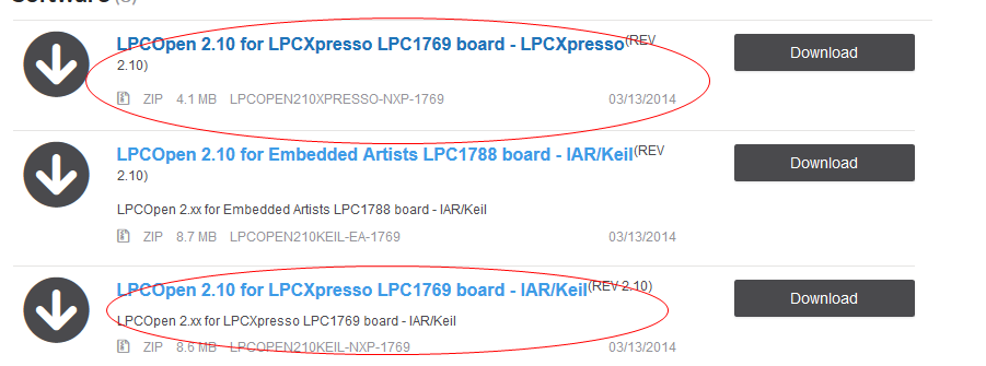

Hello Aniket Gajare,
I recommend you refer to the "periph_can" demo under LPCOpen, there is a readme.txt ,
introduce how to use and config board in detail, please download it at :
LPCOpen Software for LPC17XX|NXP
If have any question when using , please contact us without any hesitate.
Hope it helps,
