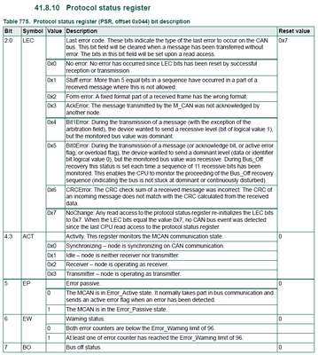

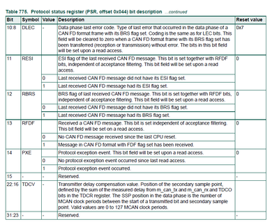

Harry_Zhang
Hi @chellapandi_1603
Sorry, i checked the Protocol status register(RSR) in LPC55s1x RM.
Harry_Zhang_1-1748500118353.pngHarry_Zhang_1-1748500118353.pngHarry_Zhang_2-1748500141738.pngHarry_Zhang_2-1748500141738.png
But i didn't find the RX bit.
Harry
2,208 Views
chellapandi_1603
Hi @harry,
You're absolutely right — I double-checked the PSR register and realized I misinterpreted the status earlier.
The flag I was referring to is actually the ACT[4:3] bits (Activity field).
In my case, it was showing value 0x2, which indicates "receiver active".
Chellapandi N
