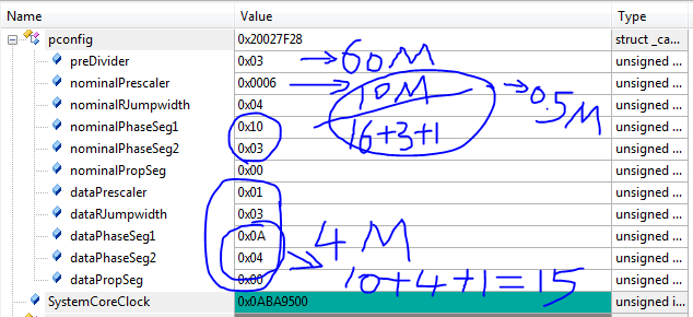

What's the max CANFD databandrate?  I can't find the define in the User manual and Data sheet; the demo give max 4M; when i try to set to 5M, it seems someting error;

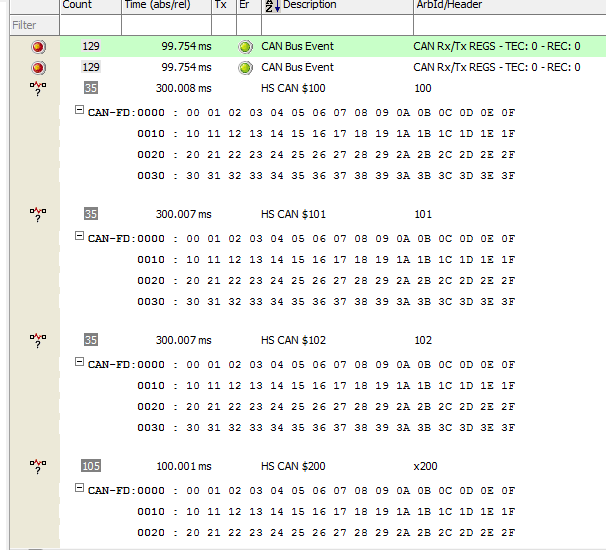

This is the data decoded:
I hope this helps you.

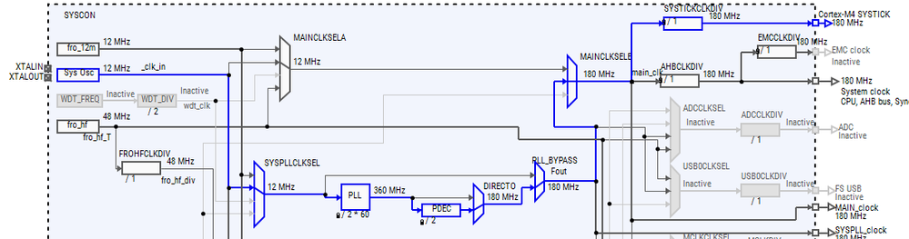

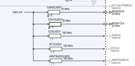

黎明孟
Hi Alexis
 i have tried to chang the sys clk to 180M with ext osc 12M, and try some clock dividers, but the 5M dataBaudRate can't work yet!
The clock tree set as follow:
and the divider set to 1,2....9 18,36.., but can't work at 5M, when switch to 4M, data can be transferred;
Data can be send with 4M dataBaudRate ;
The base line used is the demo "fd_msgobjs" and just replace the clock_config.c clock_config.h files generated by the MCUXpress;
Hope you can help to confirm with this question, thanks!

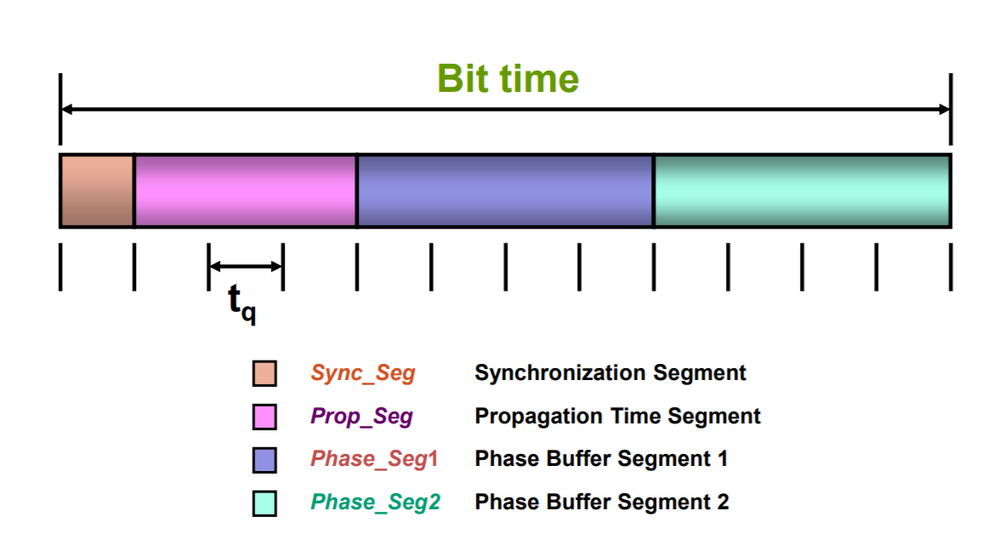

After calling the init function, I call this function to set how many quantums, I need in each segment. You can see how the bit time is segment in the next image:
The Sync_Seg is 1 Quantum for default in this MCU.
The Prop_Seg + Phase_Seg1 is set at the seg1.
The Phase_Seg2 is set at the seg2.
The preDivider is the divider applied to the CAN supply clock. In this case, I use 1 but the register add 1 more.
The clock in this case for quantum would be 45 MHz, so you will need 9 quantum to set the frequency at 5 MHz.
The seq1 and seq2 as the preDivider add 1 more to the number of quantums.
So in this case:
Prop_Seg + Phase_Seg1 = 5
Phase_Seg2  = 3
You should have something like this:
I hope this information helps you.

Hi Alexis
i have checke the resgister also,but seems the parameters are right to generater the 5M data bitrate;
The paratermeters auto calculated in
static int CAN_CalculateTimingValues(..........)
and when set to 180M
The 4M data rate;
The 5M data rate:
Then change to manual fill, the 0.5/4M works well;
but can't work with 5M no matter what the groups for the timingConifg setting;

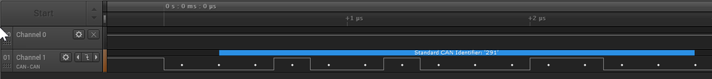

Do you have the decoded data to demonstrate the communication is OK, or can you send your Demo to me for test?
