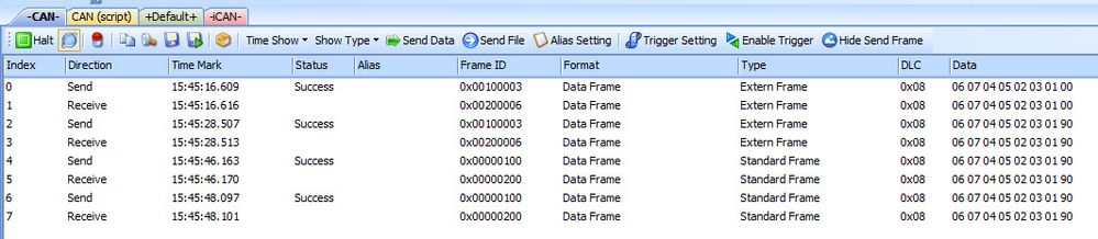

jeremyzhou
Hi sridharan TechM ,
I've created the demo, you can send the send the data which includes the standard or extend frame, the MCU will rebound the data.
                                                                       Fig 1

I have tried the same both its same, i am able to tx rx standard ID not extended id, Can I know which CAN Analysiser tool your using, jfyi I am using  KVASER CANking, let me is this compatible or pl suggest, for now i am using Lpcxpresso board
6,499 Views
