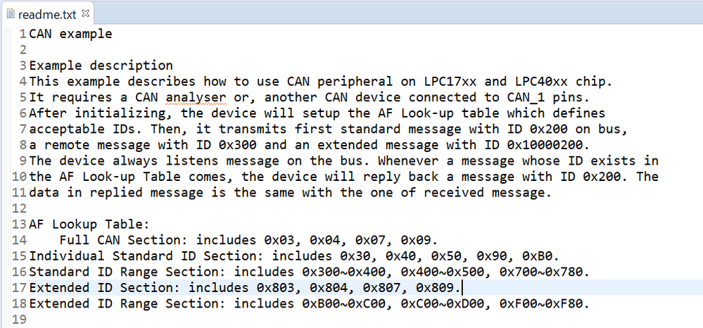

Hello madhu kumar,
I recommend you first refer to LPCopen demo , you can download at nxp website:
LPCOpen Software for LPC17XX|NXP
under project, there is readme.txt for each example, you can just read it to understand how to run it:
Hope it helps,
TIC
