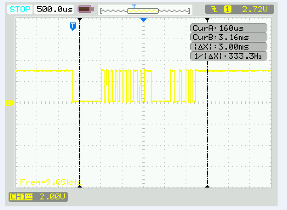

Iam having a trouble to detect the break on USART. I see on the osciloscope, that the break is active, I still receiving the interrupt on usart, but I have a problem to detect it... The if function is never true..

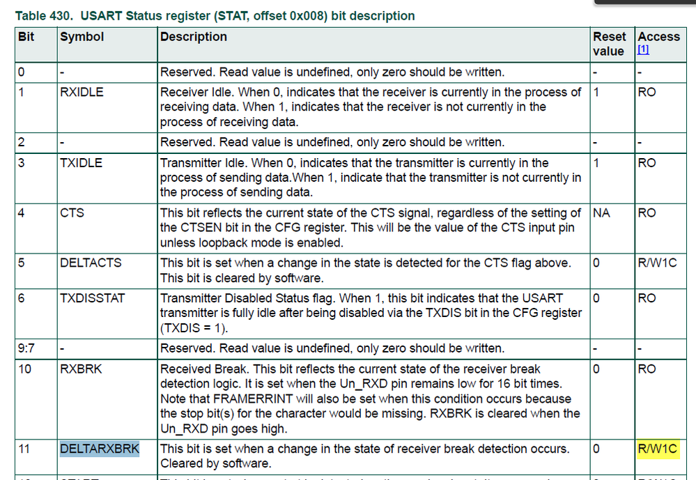

According the user manual,  the RXBRK in STAT, should be active since the break longer than 16 bits..

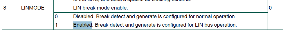

Another question, what the LINMODE in CFG does?
When I set this:
LIN1_USART->CFG |=  (1 << USART_CFG_LINMODE_SHIFT);
then the break generation doesnt work, otherwise yes.

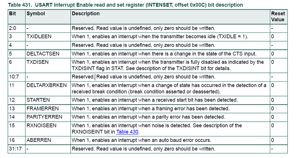

    When you enable the LIN break interrupt, do you also enable other interrupt?
   Please check this register:
  You can just enable the DELTARXBRKEN bit, don't enable other interrupt.
  Then when the LIN break happens, you can check UART_STAT[DELTARXBRK] and UART_STAT[RXBRK].

2. what the LINMODE in CFG does?
  This is the LIN break mode enable, the register already give the description.
If you use the LIN bus, you need to set this bit to enable the LIN bus break detect function. Otherwise, the UART is the normal UART break function, not the LIN break function.
About the difference between the normal break and the LIN break, please check these description:
  When you enable the LINMODE, after RX input remains low for 11 bit times, you will get the break state,and the received data is not stored in teh receive data buffer,  buf if you are using the normal operation, you will also receive the character, and the framing error status.
You can check it on your side.

Dear Kerry,
I still have a problem. When I set
LIN1_USART->CFG |=  USART_CFG_LINMODE(1);
LIN1_USART->INTENSET |= USART_INTENSET_DELTARXBRKEN(1);
EnableIRQ(DEMO_USART_IRQn);
Then the interrupt never appear. I think that the problem is with all INTENSET interrupts. When I set the FIFOINTENSET then the interrupt works.
Could you please help me how to set correctly the interrupt?

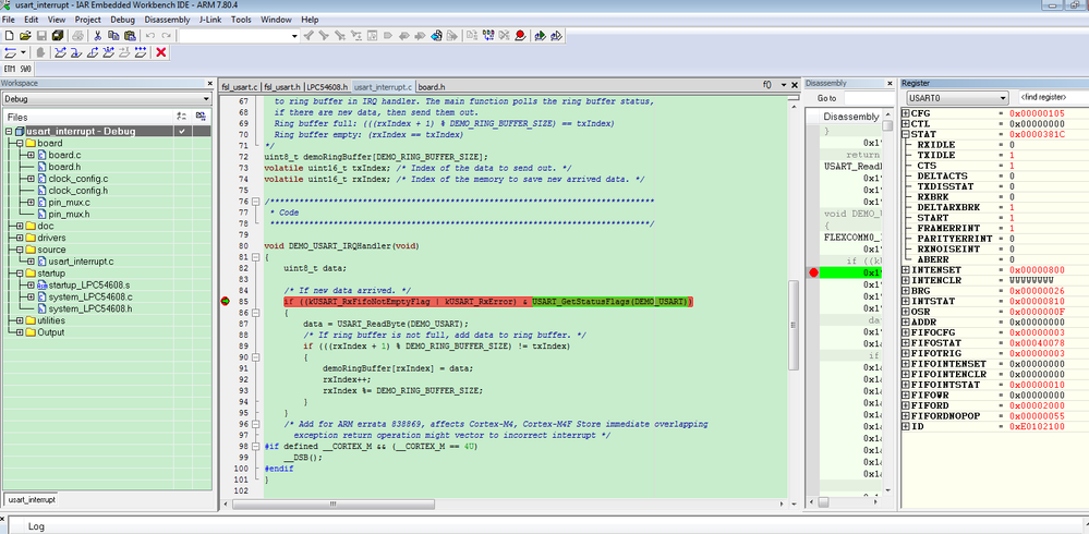

    After I enable the LIN MODE, and the break interrupt, when I send the LIN data to LPC54608, it works OK on my side.
  Please check these details.
1. Code
   I modify the code based on the SDK:SDK_2.3.0_LPCXpresso54608\boards\lpcxpresso54608\driver_examples\usart\interrupt
   Modify points:
1) fsl_uart.c
  status_t USART_Init(USART_Type *base, const usart_config_t *config, uint32_t srcClock_Hz)
Line192:
    /* setup configuration and enable USART */
    base->CFG = USART_CFG_PARITYSEL(config->parityMode) | USART_CFG_STOPLEN(config->stopBitCount) |
                USART_CFG_DATALEN(config->bitCountPerChar) | USART_CFG_LOOP(config->loopback) | USART_CFG_ENABLE_MASK | USART_CFG_LINMODE_MASK;
2) usart_interrupt.c
  main function.
   // USART_EnableInterrupts(DEMO_USART, kUSART_RxLevelInterruptEnable | kUSART_RxErrorInterruptEnable);
    //kerry add
    DEMO_USART->INTENSET |= USART_INTENSET_DELTARXBRKEN_MASK; //enables an interrupt when a change of state has occurred in the detection of a
received break condition (break condition asserted or deasserted).

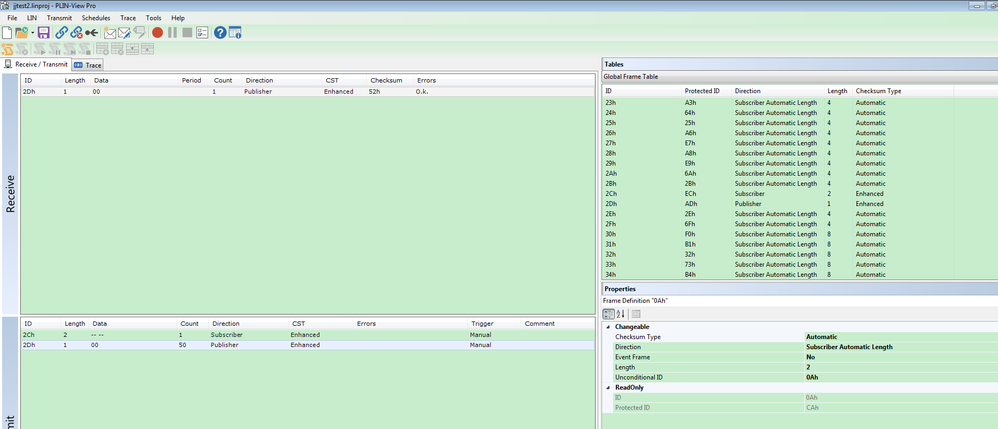

2. Hardware
   If you want to use the LIN, you need to connect the UART RX pin to the LIN physical layer.
   Test board: LPCXpresso54608
  LIN tool: PEAK PCAN-USB Pro.
3. Test Result:
Send LIN data:
You can find, I can enter the UART interrupt, and in STAT register, the DELTARXBRK is set, it means the UART already detect the LIN Receve Break.
You can try it on your side.
If you still have question about the LIN, please let me know.
Kerry

how do I clear the DELTARXBRK interrupt? Interrupt status register is read only. Since once the break is detected then I allways receiving the interrupt even if the LIN is disconnected.
Jan
10,456 Views
kerryzhou
Hi Jan Hakl,
    Please check the user manual at first:
So, if you want to clear it , just write 1 to this bit.

void DEMO_USART_IRQHandler(void)
  if(DEMO_USART->STAT & USART_INTENSET_DELTARXBRKEN_MASK) // detect LIN break
       DEMO_USART->STAT |= USART_INTENSET_DELTARXBRKEN_MASK;// clear the bit
       Lin_BKflag = 1;
       cnt = 0;
       state = RECV_SYN;
       DisableLinBreak;
    if((kUSART_RxFifoNotEmptyFlag | kUSART_RxError) & USART_GetStatusFlags(DEMO_USART))
       USART_ClearStatusFlags(DEMO_USART,kUSART_TxError | kUSART_RxError);
          rxbuff[cnt] = USART_ReadByte(DEMO_USART);;

       DEMO_USART->CTL |= USART_CTL_TXBRKEN_MASK;//enable TX break;
       while (kUSART_TxFifoNotFullFlag & USART_GetStatusFlags(DEMO_USART))
            USART_WriteByte(DEMO_USART, 0Xff);//dummy byte, no means
            break;  //just send one byte, otherwise, will send 16 bytes
       for(i=0;i<10000;i++); // delay for the break generation.
       DEMO_USART->CTL &= ~(USART_CTL_TXBRKEN_MASK); //disable TX break

    DEMO_USART->INTENSET |= USART_INTENSET_DELTARXBRKEN_MASK; //USART_INTENSET_STARTEN_MASK |

   Ok, so the problem is still the if problem, if you use the polling, you need to use the while to check the flag.
Otherwise, you can use the interrupt.
