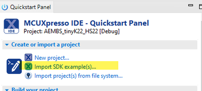

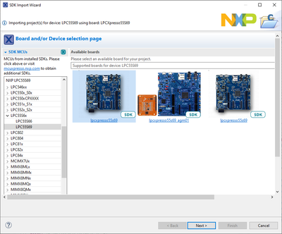

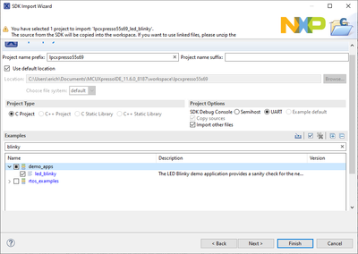

ErichStyger
Specialist I
Hi @smishra125 ,
I recommend you start with the NXP SDK examples (): they are pretty easy to understand, and there is a 'blinky' example too.
Get the SDK from https://mcuxpresso.nxp.com/, drag it into the 'Installed SDK' view of the IDE and start coding. Or use the view: Menu Show > View > Install MCUXpresso SDK.
Use the Import SDK Example from the Quickstart Panel:
Select your board:
then import the 'blinky':
build and debug, and you should have it running.
