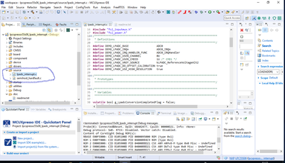

In the SDK package, we have an example as the following screenshot:
The example use the lpadc_interrupt.c, I do not know where the lpadc_temperature_measurement.c is

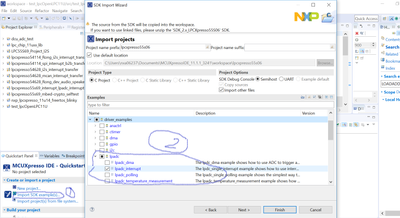

First of all, I suggest you download SDK package for the LPC55S06-EVK board from the link:
https://www.nxp.com/design/software/development-software/mcuxpresso-software-and-tools-/mcuxpresso-s...
You can follow up the following screenshot to load the ADC example.
In the above example, it use the ADC0_0 channel(P0_23 pin), in other words, it sample P0_23 pin voltage of LPC55S06.

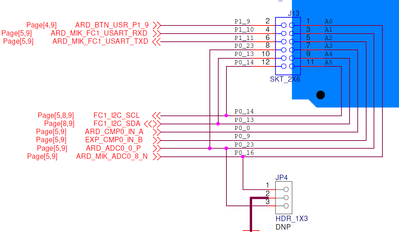

From the above schematics of LPC55S05-EVK, you can see that the P0_23 is connected to pin8 or pin3 of J23 connector.
In conclusion, you can use a cable with hole end, and connect pin3 of J23 to GND or VDD or any other voltage and check the sample with the example lpadc

Looking through the schematic, I do not see a J23 anywhere in the document. Perhaps you meant to type J13, but either way the example project is not displaying the analog values from my input to A3 (pin3/P0_23). I understand that the demo example project (lpadc_temperature_measurement.c) uses the on-board temperature sensor, but I am wanting to take in analog voltage inputs and be able to use these values.

I am sorry, I mean the connector  J13 rather the J23 for the ADC0_0 channel, in detail, pls connect the Pin8 of J13 to VDDA or GND and check the result.
