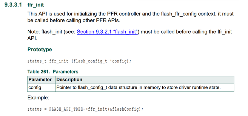

It is recommended that you use FFR_GetUUID() to access UUID. You need to complete FLASH_Init() first.
The FFR_GetUUID() and FFR_Init() instructions can be found in the fsl_iap_ffr.h driver.
 Access to UUID requires a call to FFR_Init()

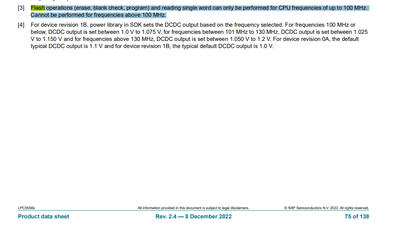

If the system clock is greater than 100mhz, FLASH_Init() is faulty. If the system clock is greater than 100mhz, the flash erase/read/program is unavailable and the UUID cannot be read.
According to the Datasheet, the CPU cannot be higher than 100M for flash to run

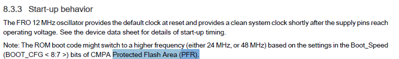

  1. FFR is a way of naming the PFR API, and PFR is "Protected Flash Region".
2. You can view the description of the FFR_Init() function in the manual, the source code is not open.

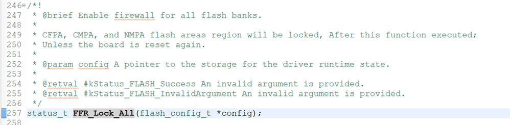

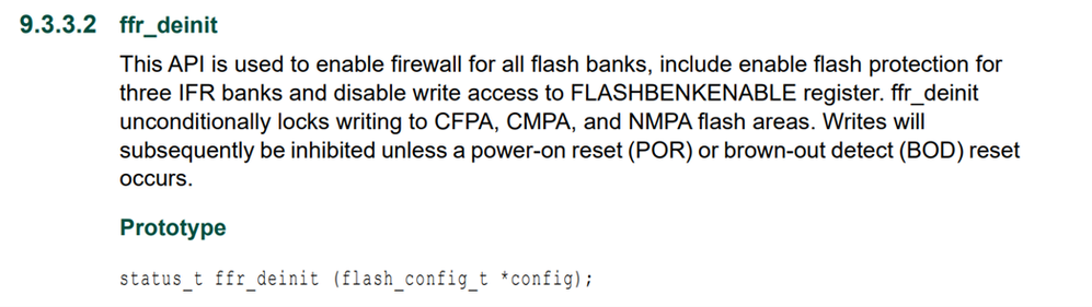

  1. use FFR_Lock_All() instead of FFR_Deinit(), the same function.图片2.png图片2.png图片3.png图片3.png
Why does it have a different name? Why isn't it explained anywhere that "FFR" is the same as "PFR"? The files include no identification information beyond their copyright dates and license identifier. Neither "PFR" nor "FFR" appear in the list of abbreviations in the manual.
There is no "ffr_deinit()" function provided by fsl_iap_ffr.h. How would one determine that "FFR_Lock_All()" is the same function as the "ffr_deinit()" described in the manual, short of tracing through the driver code to determine its order in the jump table like I just did?
What is it that ffr_deinit() does that's necessary for switching to 150 MHz? The manual seems to say that it locks flash access until a POR or BOD reset. If I'm reading that correctly, then I wouldn't be able to launch my bootloader later for firmware updates. What is the accepted procedure for reading the UUID when the system is going to be operating > 100 MHz, without locking out flash write access later on? What's the procedure for re-initializing it at a lower speed for the bootloader?

If there are Flash operations(erase, blank check, program) and reading single word, recommend CPU frequency not above 100MHZ. If you must use 150MHZ after reading flash, recommend disable modules clocks before change to 150MHZ ,( for example if you used UART in your code, disable it by "USART_Deinit()"). Then enable (re-initialize) it again after changed to 150MHZ. About re-initialize process, please refer to the Initialize code in your project, meaning initialize (enable) again.

Obviously, that request did not reach the doc team as the same issue applies to the LPC553x reference manual: no explanation what the abbreviation "FFR" means. Maybe that's an acronym for "flash firewall region"?
Further confusion is created by defining "PFR" as "Protected Flash Area":
and no information what these different flash regions are used for.
I have to agree with @scottm , the SDK documentation could definitely be improved. I would be grateful if you would start with NOT using ambiguous acronyms or different terms for the same entity and also giving some context if you introduce a new functionality.
