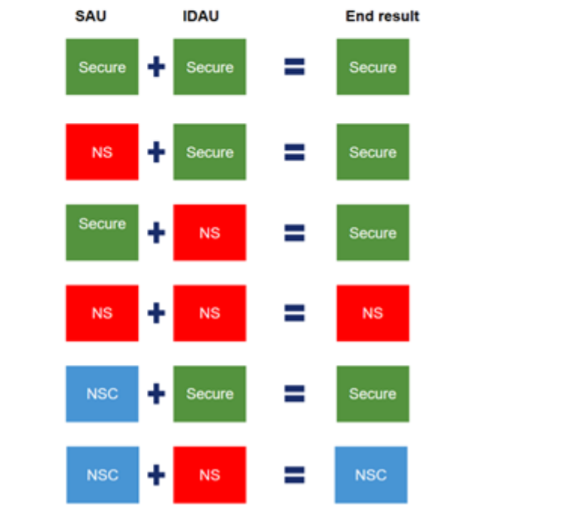

Well I'm glad you were able to at least work around this point for now and can continue with your application. However I now understand what you were trying to achieve.  It is possible that the region of memory you are trying to acces is secured at some point.
LPC55S69 Security Solutions
From the above graph we can see that both SAU and IDAU have to be configured as non secure in order for it to be truly non secure. This is probably the reason as to why you are intially getting a hardfault. I will pass on your observations from your last post, since I originally thought you were trying to access a secure section of flash from the non secure.
