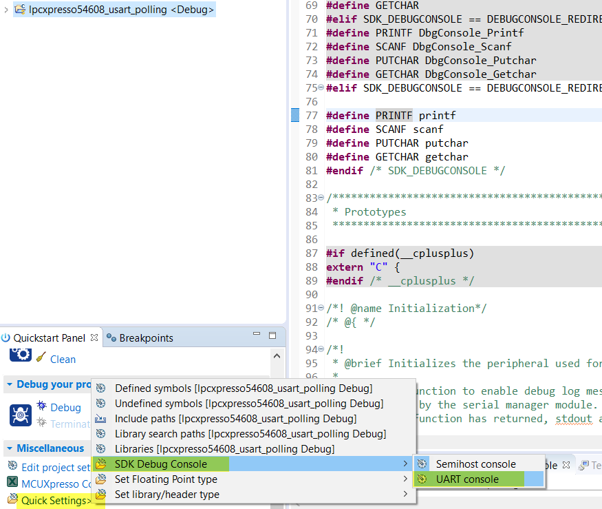

Now,i'm working on lpc54608.I used the lpcxpresso54608 of SDK2.5.0_LPCXpresso54608 code(usart_polling project).i can tx and rx to the com software.but PRINT can work.do you have any sugesst?thanks !
1,480 Views
Hello 周 周,
Please pay attention to the below tips:
1) "SDK debug console" choose "UART  console":
2) Choose the right COM port on terminal. The PRINTF transfer through  LPC-LINK USB port(J8) on board.
3) If still can't , try the Hello_world SDK demo , just connect board with J8 port, config as 1), then run it .
Hope it helps,
