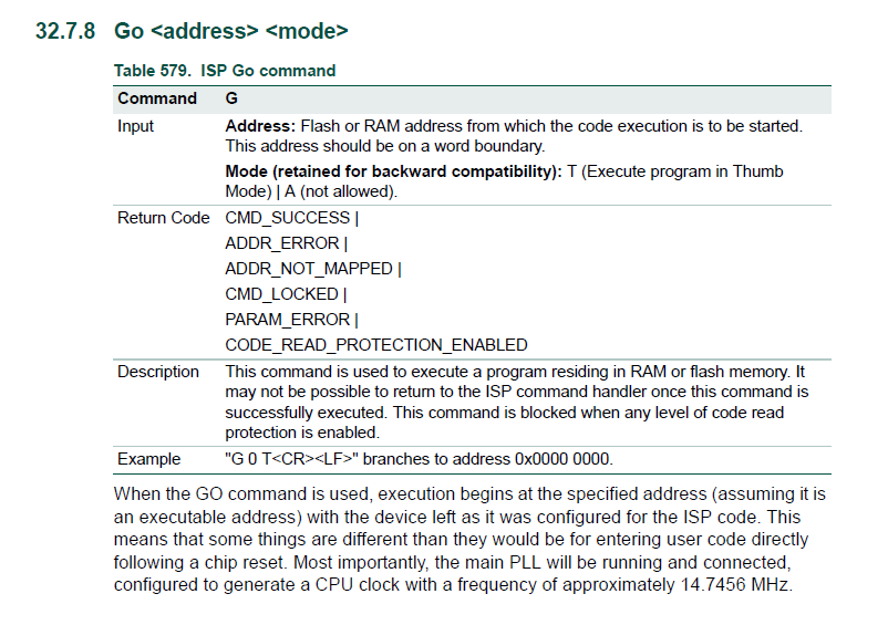

      I'm working on a software, as Flash Magic, with LPC1768 through ISP commands. Unfortunately, it worked pretty well in the early stages until the 'G 0 T' command don't work. The 'G' command is as follows.
      So, it was unlocked before runing the 'G 0 T',and return value was 0.  but the code didn't work at 0x0000000 of flash. Curiously, it worked well after reset the microcontroller by manual operation.

when use Go, you should bear in mind that it is still in ISP mode, not in the user code mode.
the main difference is the system clock,see your image below.

Hi Yu lio,
According to the statement, I think you miss call the ISP Unlock command prior to calling the Go command. So please give a try.
