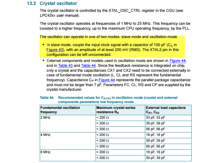

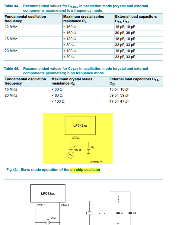

The LPC43xx microcontroller families supports different clock sources: internal IRC oscillator, crystal (MHz) oscillator, and 32.768 kHz (RTC) oscillator. The nominal IRC frequency is 12MHz. Upon power-up or any chip reset, the MCU always starts up with IRC as the clock source. Software may later switch to one of the other available clock sources.
Please check the datasheet for more information about the oscillator :
Regarding your issue, Is there i/O switching activity on pins near to XTAL1?
Sol

But my question not for clock sources for main operation and base clocks. I have no problem with IRC, external oscillator (connected to XTAL1, XTAL2), e.t.c.
I have problem with RTC oscillator. I not connected any external oscillator to RTCX1, RTCX2.
But 32kHz is present on system. ATIMER worked. And I can not find any information in manual about internal 32kHz oscillator for RTC.
