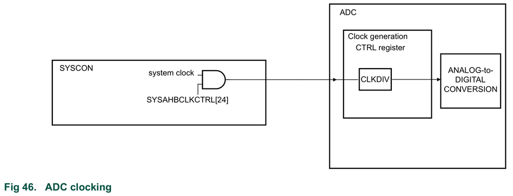

I can see why an external clock may be useful but I fear that I am still confused. The clocking diagram on page 279 of UM11065 rev.3 shows a completely different clock tree derived from the system clock instead of the FRO or external clock input:
Why are there two different clock trees and what are they used for? In my tests the ADC operates normally even with ADCLKSEL set to "none".
The reason I ask is that I originally thought clock generated by the ADCCLKSEL multiplexer was the only one used and spent longer than I'd like to admit debugging a race condition where the register interface clock (bit 24 of SYSAHBCLKCTRL above) was sometimes temporarily masked in an interrupt, during which time external triggers do not work.
To avoid future trouble I would therefore like to clear up what the these two clocks are used for.

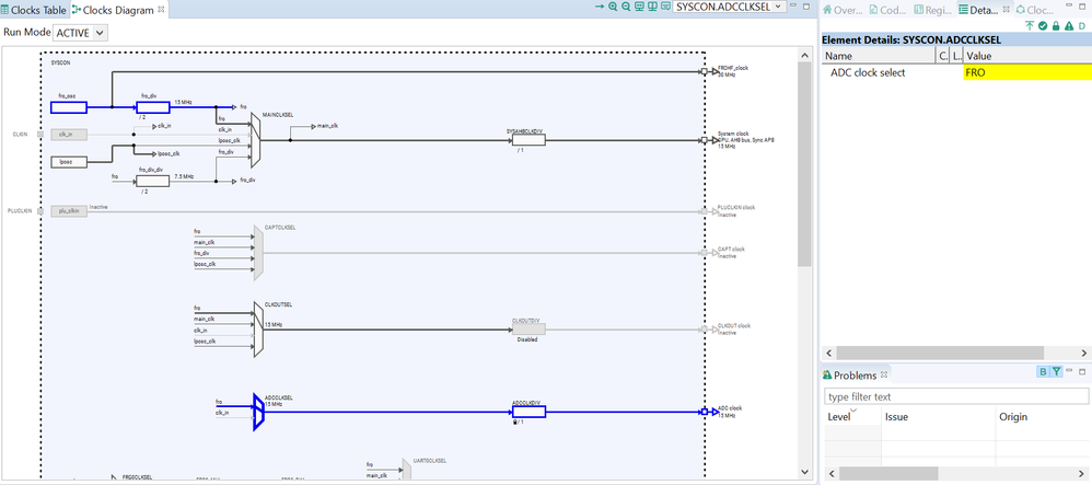

We can use this image for reference:
The signal that goes to the APB bridge that I highlighted in yellow is the signal that clock gates the ADC with the SYSAHBCLKCTRL register however to a proper function of the ADC we need a clock source to control the conversions.
These two sources can be the FRO or an external oscillator and are selected with ADCCLKSEL register, if no clock is selected then the ADC will not work as expected.
Let me know if this is helpful, if you have more questions do not hesitate to ask me.
