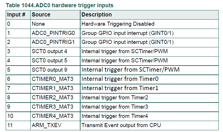

To use external pin triggers for ADC conversions, assign the pin triggers to a pin via IOCON.In addition to assigning the pin triggers to a pin, they must also be selected in the conversion sequence registers for each ADC conversion sequence defined.
The hardware trigger can be selected independently for each of the two conversion sequences in the ADC SEQA_CTRL or SEQB_CTRL registers by programming the hardware trigger input # into the TRIGGER bits.
There are 11 hardware trigger sources available. Software can select among hardware triggers.
