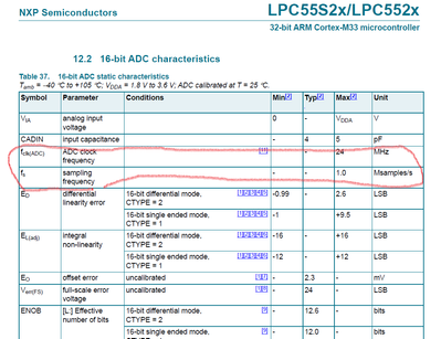

xiangjun_rong
For LPC552x, The maximum ADC clock frequency is 24mhz instead of 96mhz.
This is the ADC sampling rate formula:
ADC Conversion rate = ADC clock frequency / (Sample clocks + Conversion clocks)
The conversion mode:
In 12-bit mode conversions. The conversion time is 17.5 ADC clocks,
In 16-bit mode conversions. The conversion time is 20.5 ADC clocks.
The minimum Sample clocks is 3.5 clock cycles.
so we can figure out that the maximum sample frequency is
24MHz/(3.5+20.5)=1MHz in 16 bits mode.
24MHz/(3.5+17.5)=1.14MHz in 12 bits mode.
Hope it can help you
XiangJun Rong

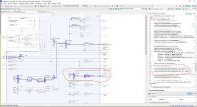

_Ferrari_
Contributor V
Thank you for your email I read it.
Unfortunately what is reported in the config tool is false (please see the attacched file)
Could you explain me better ?
Thank you very much for your help and cooperation
regards

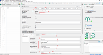

xiangjun_rong
You have to set up the ADC clock in clock menu so that the ADC clock is equal to or less than 24MHz
Then you can use the config tools to configure the ADC based on 24MHz ADC clock
You can see that single conversion time approaches to 1us.
XiangJun Rong

_Ferrari_
Contributor V
dear @xiangjun_rong
thank you for your explanation, very clear,
but, as you can see, I can set the ADC clock at 96MHz in the ADC0 tabs of peripherals tool without any error or warning.
May be it is a bug of MCUXpresso config tool.
regards
