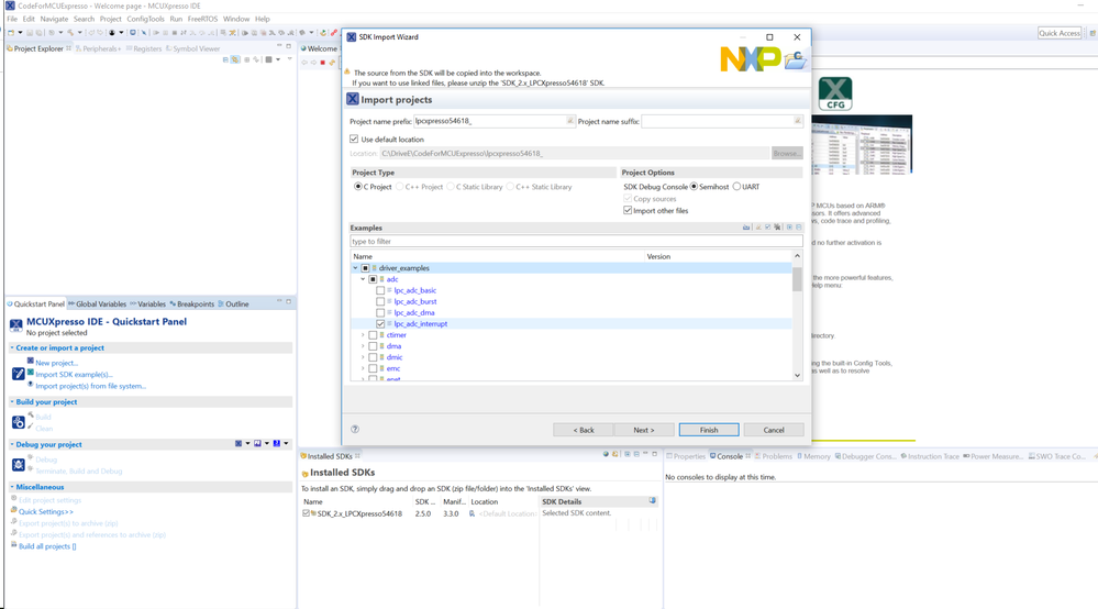

>>>>>>>Your application requires that the ADC converter is triggered by external signal from GPIO pins, once ADC is triggered, the ADC will sample all 12 channels, then stop sampling, wait for next external trigger signal. I suggest you use the example code in the LPC SDK package:
In the case, I think you can modify the void ADC_Configuration(void), change it from software triggering mode to pin hardware triggering mode.

>>>>>>>>>>>Pls use the ADC example in the SDK package.
You can download SDK package from the link:
Welcome | MCUXpresso SDK Builder
