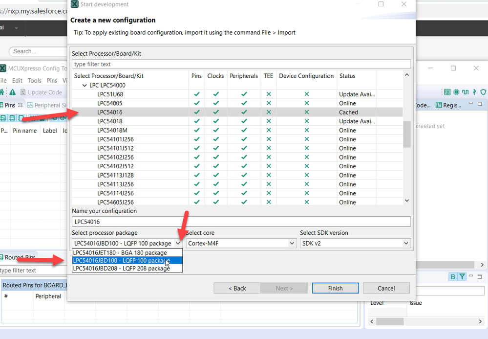

Our company used LPC54016JET100 chip.I have a problem that I used MCUXpresso Config Tools,but it does not contain LPC54016JET100.Which type do i choose in MCUXpresso Config Tools?

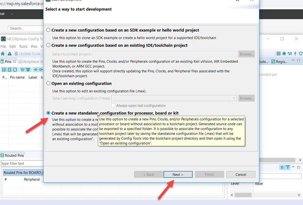

Please follow the bellow steps,
1. Select "Create a new standalon ..." and click Next
2. Select LPC54000 -> LPC54016,  on "Select processor package" select the device you need,
Sol
