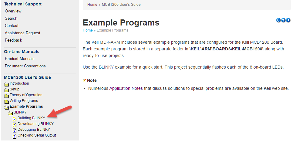

Hi frnds,
i am trying to program led blinking in P0_30 using LPC1225/301 microcontroller. there is no error in this program. but led is not blinking. can anyone suggest me what is wrong in this program.

jeremyzhou
Hi Dhinesh E,
Thanks for your reply.
I'd highly recommend you to refer to BLINKY demo from the ARM Keil for details.
MCB1200 User's Guide: Example Programs
