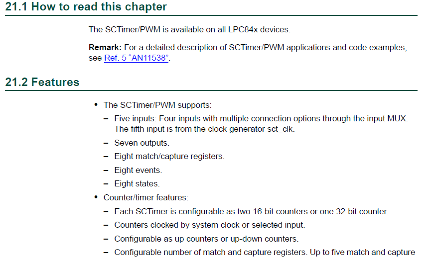

I am using LPCXpresso845MAX board for testing my application.
I required 6 PWM outputs (3 complimentary pairs of PWM).
I refereed 'AN11538_SCTimer_PWM_Cookbook v5.0.pdf' and i came to know that i can use SCTimer to generate complementary PWM.
I am using MCUXpresso IDE and Peripheral Config Tool to init SCTimer. I can able to generate 4 PWM outputs (2 complementary) using SCTimer. But when i tried to add another PWM output tool show me error. 'Each PWM output internally allocate 2 events. And Max Number of events supported by SCT0 is 8' See attached image.
So how can i generate 6 PWM outputs at a time?

Hi, Ritesh,
The generic SCTimer/PWM module supports 16 events and 16 states, but the LPC804 is a scaled SCTimer/PWM module, it only supports 8 events and 8 states. The AN11538 focuses on generic SCTimer/PWM module, so if you use the code directly, maybe there is issue.
Hope it can help you

I’m using LPC845. And as per its data sheet it only supports 8 events and 8 states.
I'm using MCUXpresso Config Tool for SCTimer Initialisation. The tool don’t allow me to enable more than 4 PWM outputs. I had attached error snapshot in my first post.
So can you confirm that In LPC845, is it possible to use 6 PWM output using SCTimer?
If yes could you guide me how can I initialise using MCUXPRESSO config tool or manually register config !??
