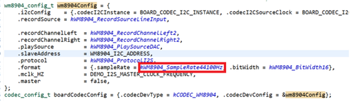

I will provide you an example to how use the I2S module modifying the SDK (version 2.15.1) example called "I2S interrupt transfer" that uses the next parameters (this in order to show an example that might help you):
Sample Rate:44.1kHz
Channels:2(default by the example).
Bit With: 16 (default by the example).
Protocol: I2S (default by the example).
Codec: WM8904 (codec of EVK).
In order to run the I2S at 44.1kHz we need to start modifying the MCLK of I2S, this depends totally on the sample rate according to the next formula:
This value can be changed in the code modifying this macro:
Consequently, the example uses 48kHz of sample rate. However, this can be changed modifying these sections of the code:
  In the section of the macros, you need to change the next values:
Finally, in the part to configure the codec, you need to change this value (note: the SDK provides an enumeration that helps you switch more easily):

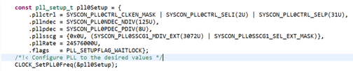

I also noticed in the PLL setup that it is set to 24.576MHz - the frequency for 48KHz audio.  If I change this to match the 44.100KHz audio - 22.579200MHZ - that the sound goes back to 48KHz, independent of the other settings you said to change.
All of the calculations seem to be correct.  Perhaps they aren't getting set properly?  What else should I be looking at?

You can change the frequency of the I2S clock changing the PLL frequency, this because the PLL is who generate the source clock of the module.
In your case the frequency is 22,579,200 Hz as shown the response that I provided you.
Specifically, the part of the code that change the PLL frequency is the next:
In the last structure the code configures the PLL with diverse dividers and multipliers to obtain the specifically frequency (in this case is 24576000 Hz).
In the other hand, to corroborate in which frequency is providing the PLL clock you can use the function called "CLOCK_GetPll0OutFreq()". At the same time, config tools could be help you to configurate the PLL clock in the next window:

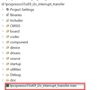

Also, In order to support you better, can you provide me the file ".mex" if you used Config tools, or the structure that configures the PLL0 if you configured manually ?
You can obtain the file .mex in the last files in the project:
