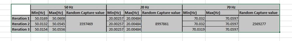

   I am using LPC54608 development board(OM13092) for evaluation of 32 bit capture in Standard counter/Timer module of LPC54608 controller. I have modified the "simple match interrupt" demo code of ctimer module to capture a square wave of freq(20-70 Hz) at pin P2_0 of CT1_CP0(Timer 1 , channel 0). The error seems to be slightly on the higher side. I have triggered capture on both the edges so for a 50 Hz signal i would get 100 Hz output. I am expecting an accuracy of +-0.005 Hz. I have tried with 48 MHz as well as 96 MHz APB Clock frequency but still unable to acheive the desired accuracy. I have attached the code and test results for reference. Please help.

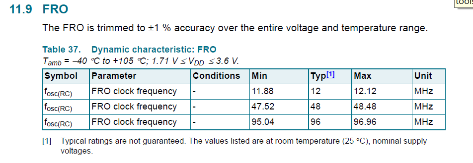

Regarding your question that you test the external signal cycle time with CTimer capture faeture, from your code, it appears that you count the tick which is 48MHz internal clock, pls check the following FRO section, after trimming, the internal clock is of 1% accuracy, and the stability is bad.

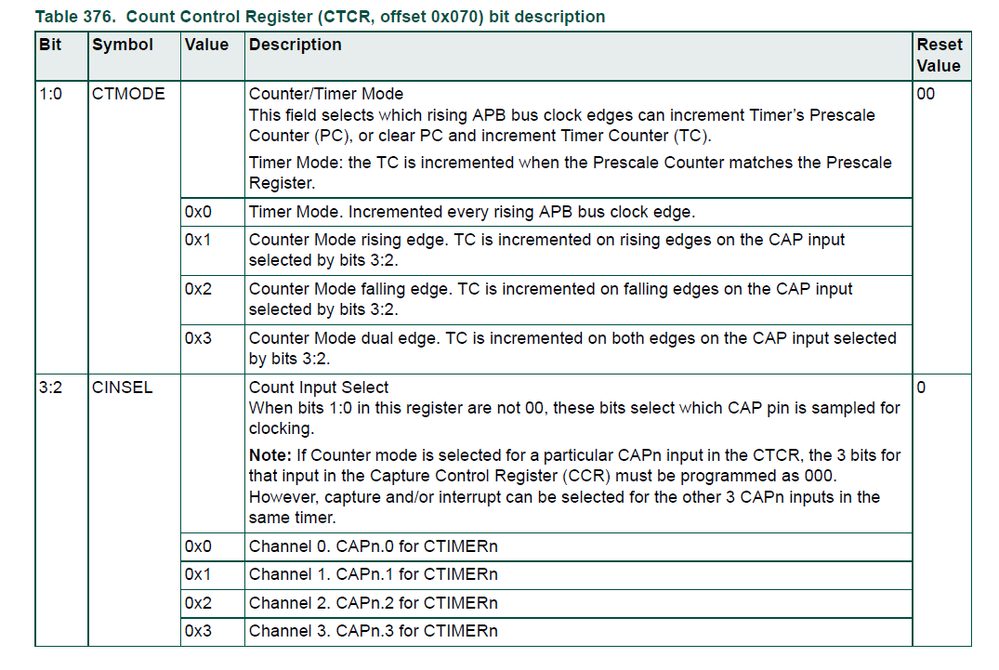

I suggest you connect an external clock source as the tick clock source, the CTimer can count the external clock source, the external clock has high accuracy and stability. From the Table 376, you can connect both the tested signal and clock source to the capture pins, it is okay.

First of all, I think it is good to use external clock source as tick, but I do not know whether there is difference between the tick clock which you use internal PLL to times the low frequency external clock to get and the external high frequency clock source which is used as a tick directly. I think you can have a try. For the second method, you can connect both the high frequency clock tick signal for example 48MHz and the tested signal to the CTimer capture pins.
