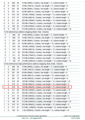

It is okay to connect two IS43s16400 to LPC4357, for hardware connection, as you know that the IS43s16400 has:
column address: A0~A7, b bits
row address:A0~A11, 12 bits
bank address: 4 banks, BA0/BA1
You can connect the A0~A11 to the EMC_A0~EMC_A11, connect BA0/BA1 to EMC_A13/EMC_A14, connect the other signal as usual.
For the software configuration, you can configure the DYNAMICCONFIG[0] as
Pls refer to section 23.7.19 Dynamic Memory Configuration registers in UM10503.pdf

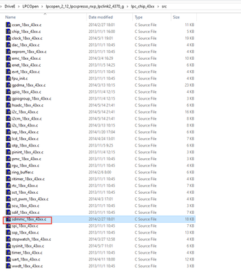

The LPCopen has the SDRAM code:
You can download LPCopen from the link:
https://www.nxp.com/design/design-center/software/software-library/lpcopen-software-development-plat...
Hope it can help you
